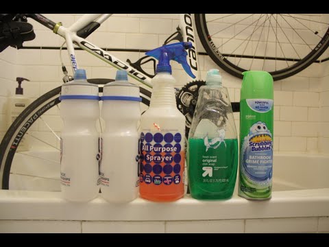

Adam, I am on the lazier end of the spectrum with you. Car wash (which I learned from Eloy), when I am disgusted with my bike or I am coming back from a particularly muddy CX race. Then relube chain, and pivots of derailleurs.
Occasionally degrease the drive train with Scrubbing Bubbles (most awesome thing ever). Then relube the drive train parts.

    Scrubbing bubbles?  Is that better than degreaser?  Why?
Scrubbing bubbles is awesome because:
a) it works exactly the same as degreaser.
2) the bubbles get into everywhere so it can clean places that are harder to reach so you don't use all your Q-tips like Bruce.
III) It is easy to find in every Duane Reade or supermarket.
* Significantly cheaper than bicycle specific degreaser (oz per oz cost).
Finally you can use it to clean your bathroom after you've cleaned your bike in the tub (potentially saving your marriage).
