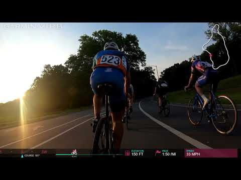

More relevant than power numbers - if anyone can find KCC Alum Marc Bertucco's instructional in-race video on youtube of a race in Prospect Park.
Ah, yes.  I've been looking.
I"ve asked Marc.
He doesn't know.
I think it was with Brendan Rigby's GoPro.  I found Brendan's youtube page, don't see the video.
Regardless, I'm happy to either meet in person or do a webinar on what to expect.
it’s on the forum here somewhere… an unlisted video.
I looked and you last mentioned it in 2018 in the Castelli Series thread
I think this is it, but the annotations seem to have been lost
https://www.youtube.com/watch?v=8vQgYqWsygI
In the guidebook for the Milk Ras I did, they thought it wise to include a joke about the race: "I didn't realize Ireland looked like a racer's arse."  A quick scan of the above video; I can recognize many racers that way.
I also found this on the same page, a cat5 race in Prospect on June 9, 2018.
Our @ErikPfiffner got third.  Here's his race report:  "Thanks for the mention! It was a quick Cat 5 race averaging 26.1 mph.  Only being 5 laps, I was able to focus on my positioning on the final lap.  I was roughly 5th heading up the hill and hopped on the wheel of a very strong CRCA GF Capital rider.  I was red lined and attempted to pass him when he moved a meter over, forcing me to stop pedaling (not sure if I even had any left in me to truly pass)...overall very happy with 3rd! "
https://www.youtube.com/watch?v=0QETvJEmqLI
That looks like Rigby, not Marc. Marc would never ride in the wind to get to 3rd wheel at the start of any road race.
Here's what I found from you in June, 2018
Jules Cyclist
June 2018
I'll cx post this under skills but this race video is worth watching for the new 4's & 5's
It's an annotated "how to race in the pack" video by Kissena alum Marc Bertucco.
That's what I was basing it off of. (and it is cross posted in Skills)
I'm obsessive enough that I tracked it down in the L & C thread from May, 2014.
If you start from March of that year, you have some interesting notes on first racing with the 1/2/3s.
wow, nice detective work! I wonder why the captions got stripped? I remember Marc spent a ton of time on those
What a crying shame.
https://www.google.com/amp/s/www.theverge.com/platform/amp/2018/11/27/18114581/youtube-annotations-discontinued-january-2019
