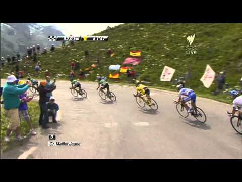

Sounds right on paper, but let's see Mr uci.edu back his theory on the galibier.
http://www.youtube.com/watch?v=MSmhgOFGl_M
John,
In fairness to Brandt, those roads are smooth.  Not all the riders stick their knees out.  Contador and Thomas don't.  Samu does on some corners.  And just because these guys use the technique doesn't mean it's the best.  I've mentioned this before, but the RadioShack Leopard team actually had a cornering clinic taught by the speedplay owner.

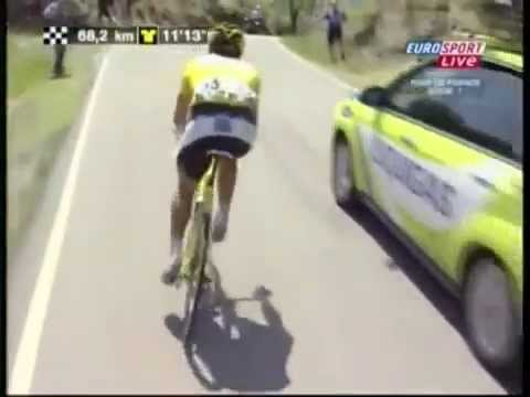

You'll see that most riders keep their eyes roughly parallel with the ground in long turns.  This is mostly natural, but it's also practice.  This makes keeping equilibrium easier--easier to get out of the turn and figure out what straight is.
Good descending is also knowing the quirks of the descent and focusing way up the road. You know Sparticus has bombed this one before...
http://www.youtube.com/watch?v=RxXqQqAc2pA
Ah, yes, Spartacus having some fun on a descent.  We should all be so good.
